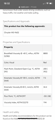

I have finally found the answer, yes you can use atf 4 in your transfer case, Chrysler did there best to hide the specs on the TC fluid, but I found it on an MSDS sheet, it’s virtually identical to atf4, the first picture is mobile 1 synthetic atf4, the second picture is BW 44-44

i dont think anyone doubted the possibility of bw44-44 being atf+4. truth be known , dexronlll would probly do just as well and was used in many tcases over the years. toyota had the only chain drive tcase to use something other than atf as far as i know
