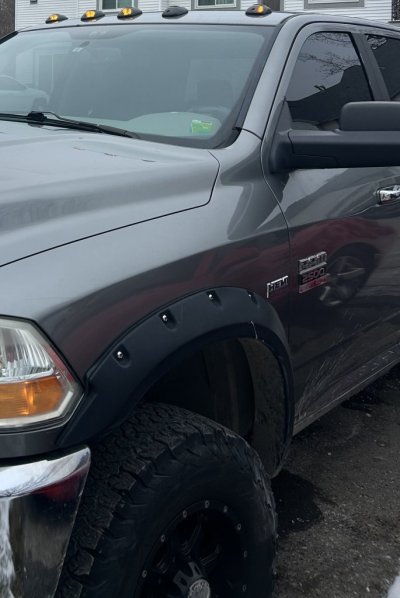

Well I replaced the battery. Lights still flicker. The one on the end drivers side you can see half lit but it flickers to full lit. Second one is out. Sometimes third one is out. Once in awhile they are lit. IMG_3862.jpeg

Looks like these trucks do not loke LeDs is the problem.

I'd like to switch back to ones with bulbs but not sure how difficult it is.

These almost look to be "aftermarket" ? By the looks of them you just can't change out the bulb. If that is the case you have to change out the entire light to get back to an incandescent bulb. There are complete OEM cab light kits that are pretty reasonable, or you can check out places like Geno's garage.
