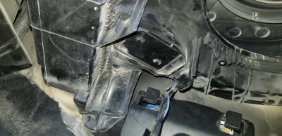

I've looked but cannot locate the resistor.. the flat panel with two "screws" on your picture is in mine too but they are not screws but screw like nipples made from plastic and permanently part of the flat surface. I also can put my hand through the hole where the motor was to find that on the other side of this panel there is nothing... Maybe one you refer to was a different year ?
Any other suggestions? I will connect the motor to battery directly next, to see if motor works.
Here is picture of what it looks like down there for me. 8c9e7a95e79bdfc98a8196bf819073dd.jpg

Salmore, I found this video on You Tube Does your fam look like this one ?? If so the resistor is on the blower fan ! Hope it helps
S
salmore
Aug 9, 2019
16
poland
Yes. Looks more like this one. And I'm being told you cannot just plug it directly to battery to test it...
So... Based on this video it seems you need to replace the whole thing as resistor is part of it... So i think I have to just hope for best and buy a new motor....

I’m not 100% but from looking ,it appears that the resister is now integrated into the blower motor itself ! This is why it’s not showing on any parts sites ,or on your truck. However I I have also seen that amazon carries the blower, and thought this might be a replacement option. Good luck.
