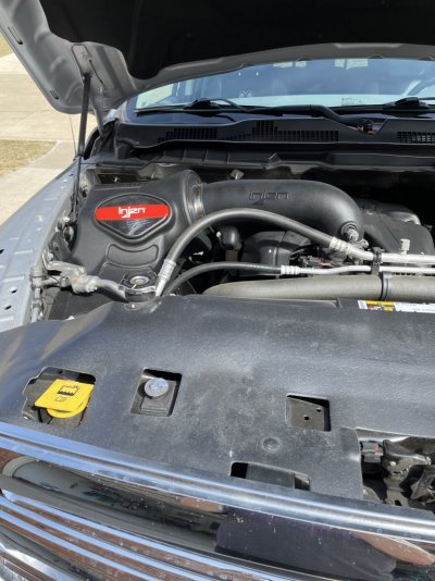

I put this Injen cai on my 2019 classic. Fit great, looks good, got a good price.
Performance results: no increase in anything. Mpg is the same, power is the same, being enclosed the sound is the same.
Most cai manufacturers advertise minimal power gains at or above 4,000 rpm. Who drives in that rpm range on a daily driver basis????
Total waste? No because I like the look. A lot of $$$$ for a look that no one sees except the guy that changes the oil….oh wait, that’s ME!!

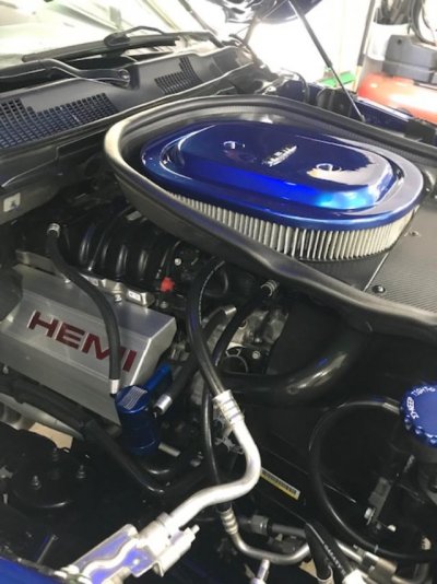

I have to admit the Vararam sure looks good when you add a few other under the hood accessories.
