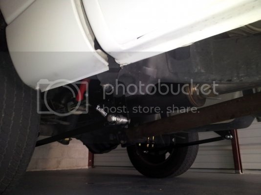

I put mine in the 3rd hole(bottom) and extended the bars(each the same number of turns) till the back of my truck went up 3/4" measuring from the ground to the hitch. So far so good but I am still tinkering. They also give you directions with the caltracks on how to set them up for a starting point.
