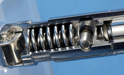

I believe it’s more than just disabling them. The lifters if you look at pics is like a lifter with a large spring Inside of it. Replacing the lifters and disabiling the MDS is necessary. I don’t remember what fails but it’s not the MDS programming or system, but the physical lifter fails and whipes our the cam.
Sorry I got the GM DOD lifters confused which I have more experience with in my LS builds. It’s common to delete the valley plate and run normal lifters and never have an issue again. I’m talking 250k plus miles on a stock Engine.
Here are some pics of the ram hemi MDS lifter. My guess is they collapse or lock up due to the spring or the lifter plunger when the MDS controls oil flow to the lifter to enable or disable the lifter.

Basically, the lifters fail and dig into the cam, throwing metal into the motor which contaminates the rest of the lifters or engine.
I could be (probably am) wrong, but I was under the impression that fuel shuts off to said cylinders, the lubrication of the lifter is NOT affected.
Speculation here, the lifter fails because it is a complicated design and it isn't getting the necessary lubrication to the correct pieces and parts in the lifter.....KISS, the more moving pieces the more chance for failure.
Right knew that but just wondered if those lifters were the ones that fail everytime or if it was more random.
