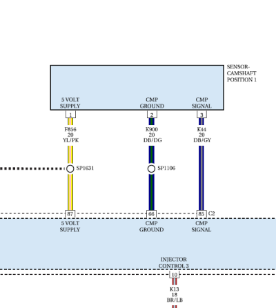

The circuit they are testing is pretty simple. When you say "CEL return", assuming the same code every time?
So, they have tried new wiring from the PCM to the Sensor? They've tried a new sensor 2x, and they have tried another PCM? The exact same problem returned each time?
If that is the case, then everything involved in that entire system has been replaced except the reluctor wheel, which is mounted on the cam phaser on the front of the camshaft.
Then, yea. That might be the next thing i'd be looking at too.
But,
Now, assumptions are variables and historically cause alot of problems to be passed over and not be solved. You know the old saying, "ASSUME" makes an ASS out of U and ME.
The wiring from the sensor to the PCM included the terminals inside the C2 connector on the PCM, that would be pins 87, 66 and 85. Did they drag test those terminals? de-pin those terminals and replace them, inside the connector? Or, did they snip the wires and splice in a replacement section, leaving the old terminals?
Because the intermittent nature of this problem would have be inspecting the pins at both ends of this circuit, really really well! Since the sensor end "pigtail, i guess", has been replaced, that kinda points to the other end. Loose pins/terminals inside a connector are amongst the most common intermittent electrical problems, and most difficult to find.
The diagram above shows two splices in the harness. Splices sp1631 and sp1106 would also be worth looking at.

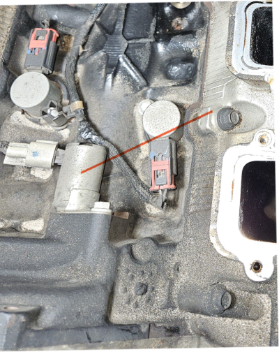

Bad VVT (oil control) solenoid? It does control the cam phaser, I believe.
I know on mine the little plastic cap inside the connector came off, and would fall off when I unplugged it from the VVT solenoid.
I did not replace it, but made sure it was on when I reconnected it to the solenoid.
The way I found it was I noticed the push-on wire tie mounts for the MDS and VVT harness were broken. I found a couple small pieces of them on top of the block, and I had previously vaccumed, so I checked inside my shopvac and found the remaining pieces of them, along with that little cap from the VVT connector.
I looked because after only finding part of them, all I could think was that they fell into the oil galley when I had the MDS solenoids out. Needless to say, after I found all the pieces, they went missing like Jimmy Hoffa.....lol.
I wasn't sure what that little white cap was from at first, until I looked at those connectors closer.
I had no idea it had fallen off the connector, either.

Thanks all! I will forward your suggestions! The oil control solenoid is under the intake manifold (another item they could have checked since the replaced the intake manifold gasket) as part of these repairs since they said it was leaking oil.
EdGs
Nov 29, 2020
5,704
12,105
FL
Yes it is under the intake, at the very front, on it's side, facing forward.20250525_091141(1).png
