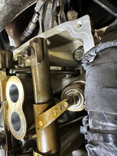

One thing is not like the others! Always double check your work!
