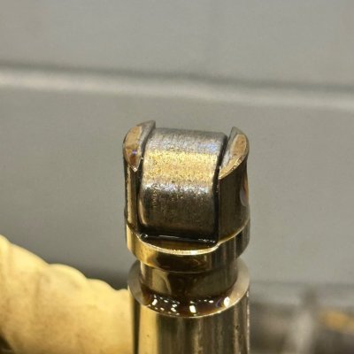

The results are in. It was the #3 cylinder lifter bearing that collapsed. Here I was blaming the MDS gods and it was a non-MDS lifter. The cam lobe is definitely "chewed up" but was still within spec to keep from throwing any codes. Can't say it would have lasted much longer. Hoping to have it back together soon.

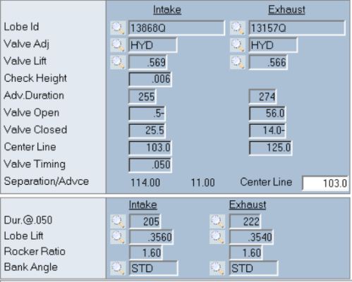

Comp Cams does the grind for Greene cams.
Look for serial # on the box (example: Serial # 227114-18)
Will get spec card like for the 1.5HL attached.
Get in touch with Tommy Oden @ Comp Cams
I called COMP last week and got the cam specs based on the SN. G2G now.
