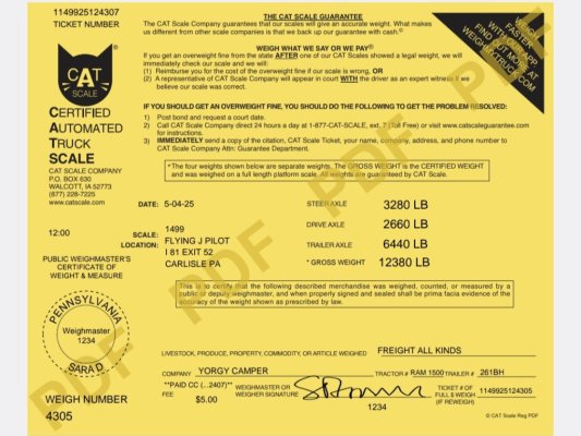

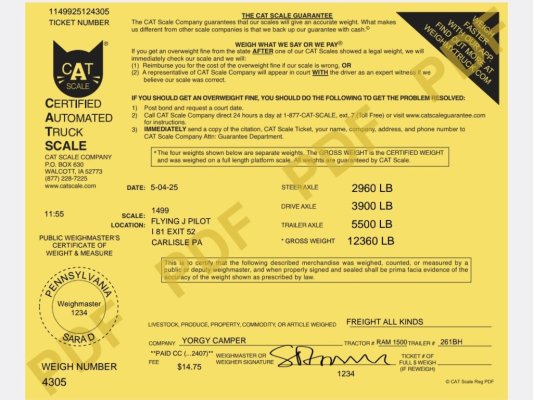

Here's the weights, about where I thought they'd be. I'm gonna adjust the hitch and try to get a little more weight in the steers.
Hooked up...
Unhooked...

Check your GRAWR. I think it's 3900lbs so you are right at that limit. Shifting weight to the front axle should unload the rear a little
Yes it is & I've already adjusted the hitch. Gonna see how it feels tonight when I take it back to where I park it.
