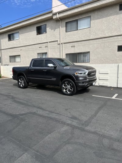

I have the air ride with the 2.5 leveling kit. I just put 35x12.5r22 stock wheel and they fit.

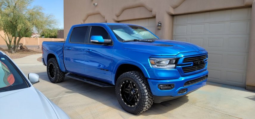

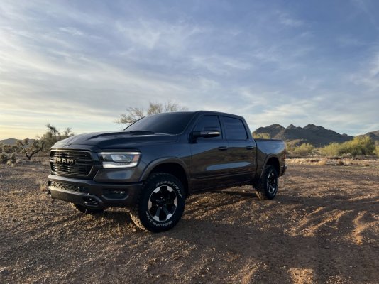

I am on 2" coils in the front and 1.5" springs in the back and have a ton of room on 33's. I feel like 35's would fit my setup well, and plan to to that route after these are toast. This photo was before the 1.5" coil springs in the rear. I have also since gone to aftermarket wheels with 0 offset and that made a huge differnece in clearance between the tire and control arm. Not that there was an issue before.

35x12.50 with a 2.5 inch lift. I had to remove the plastic mudflap piece.
