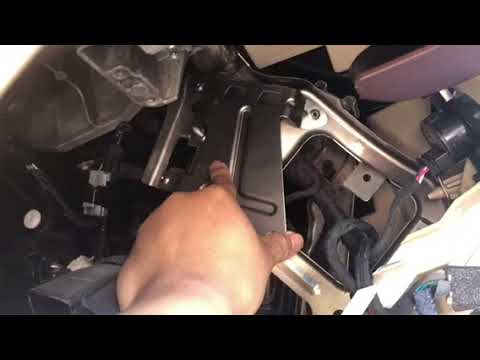

Before going to far watch this video - at the 7 minute mark they show the location and the plugs for the wiring for the oem controller. The wiring is there on most of the gen4 trucks, but being a 2020 it would be good to check. If the wiring is there do a search for ITBM installation on here or just have your dealer install it and activate it or use aftermarket.
