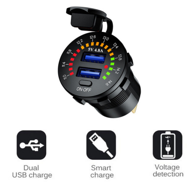

If you have a cigarette lighter & don't use it
On Rams in the past, they remove the cigarette lighter & install a usb charging port in its place
The cigarette lighter works off of a fuse that has 3 pin positions
using pins 1 & 2, it is always powered, using pins 2 & 3, it is powered with the ignition
something similar to this would replace the cigarette lighter
Nice ... that is what I was looking for lol ..thank you @GTyankee ... I am going to be removing the cig lighter and adding another usb

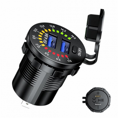

some of those adaptors have 2 USB slots, a 3 amp & a 5 amp
some also give you the alternator output or battery information
vehicle voltage display
