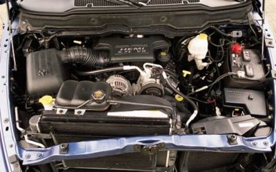

Make sure your heater setting is on high and park on incline where the radiator cap is higher than the motor.
With the 03's the rad cap is always higher than the engine, they're the weirdos with the cap on the puke tank instead of the rad itself.
After a thermal cycle where it doesn't explode, have you vented the cap to let any trapped air out? Stupid question, did the hoses go back on the heater core the same way they were before? I've never had this problem at all (going on 15yrs now) which makes me wonder what's going on with yours...

That is a old style crappy system jeep used the same type for the coolant system with the bottle. I would try and jack the front of the truck up so the engine is pointing up and the rear of engine is down. This way air will flow to the front and come out the opening in the bottle.Also you can bleed the air on the engine from the brass temperature sensor ,just on screw it till the coolant flows out with no air it. I would make 100 percent ,because you,ll warp your heads and be up ***** creak.
