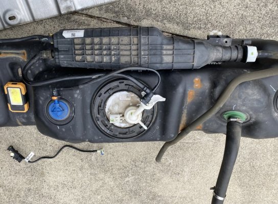

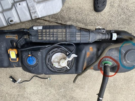

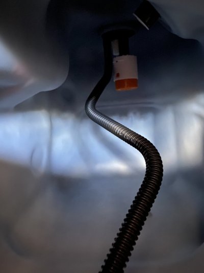

It’s not repairable. Lots of info on this site about fuel filling issues. On the pic below the red circle is the location of the “rollover” valve. It’s nothing more than a ball bearing held into a seat with a pressure spring. Removing the steel ball will not fix the problem. I know because I tried and it only made to issue worse. The area of the pic circled in blue is some type of vent but it’s molded into the plastic tank. The second pic is of the inside of the tank showing the vent area circled in blue from the inside and associated hose that runs to the fuel pump.

The pic below shows the top of the fuel tank. The white circle in the center is the fuel pump. On the left side is a blue vent that connects to the fuel pump from the outside of tank. I have no idea how it all works but I can tell you that everything is molded into the tank except for the fuel pump. Nothing is replaceable on the tank except the fuel pump. If your mechanic figures out a fix without replacing the tank it would be a great service if you could post it here.
That's the fuel fill limiter/vent valve. It allows a tank to vent to the carbon canister until a certain point the valve shuts. It's definitely an issue on these and some GM products for some reason.
Thank you for that information. I’ll assume that little gem is the five dollar reason we have fuel fill issues. It stinks that it’s not replaceable.
