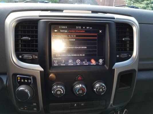

Yes ^^ this.. please post a picture of your settings page as well as a picture of the bezel around your radio. As for unconnect, If the radio didn't come from the truck, even if you had the button, you won't be able to get uconnect online services. I'm curious if you have an 8.4 radio threw into a standard RA1/2 bezel or if you have the infotainment bezel.

That is the infotainment kit that gives a correct bezel with a volume button for those that do not want to do a full conversion. You may be able to contact them for support. @infotainment.com @[email protected]
https://www.infotainment.com/collec...0-3500-gps-navigation-8-4an-ra4-radio-upgrade
You could also finish the upgrade by buying a single zone bezel, HVAC module, and conversion harness. Total cost would be less than $500. However I doubt it would fix the navigation issues that you are experiencing.
