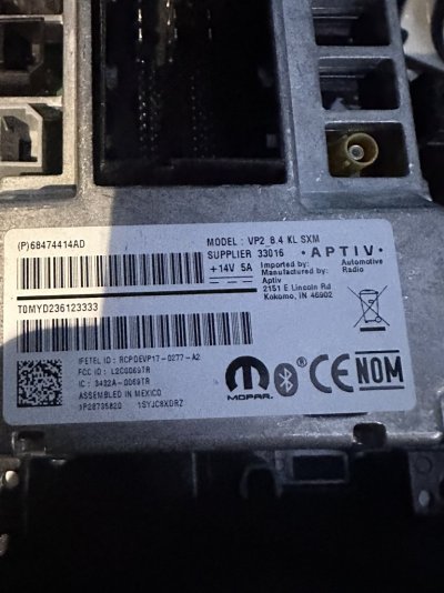

no audio like it seems dead, it might because its incompatible with my truck i have 2017 express and the radio is from a 2021 jeep
i might need to purchase a radio from a ram classic to make it work
That would be my recommendation. You want a UAS or UAQ 8.4.
