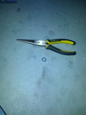

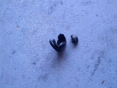

I traced the linkage and found the damage. There is a plastic retainer that secures the final piece of linkage to the transmission. It was cracked and allowed the linkage to fall out of place, hence the lack of feedback from the shifter. I went to Home Depot and spent $2 on some washers and re-attached the linkage myself! See attached pix.
