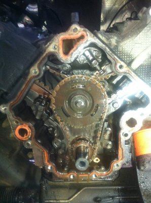

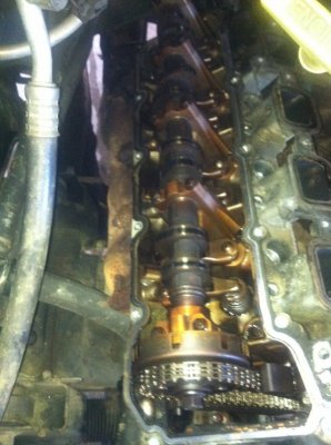

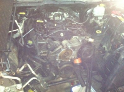

im pulling the radiator and front section of the truck off now, and i guess gonna work my way thru the engine.....ughhh
J
Jan 12, 2014
36
2003
4.7
some pics

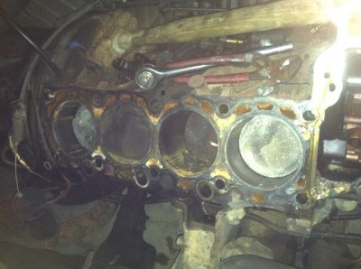

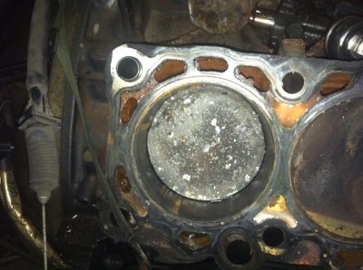

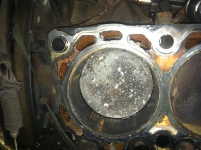

this is what i found, i dont know why but my front and back piston are toasted, any ideas why only those two pistons where toasted?
There is the problem like I had said. Burnt pistons which in turn burnt the top rings which is why fuel is getting into your oil pan. Only recourse is to rebuild. Get the pistons from AirRam that I linked for you earlier in this post. Not sure what may have caused the problem for you but it is somethinghtat every owner of the 4.7l needs to know about. The upper rings on the stock 4.7l pistons is only 1/8 of an inch from the top of the piston, which is too close for any modfications. Now while you have the engine apart best thing to do is to check everything else to be sure there are no other broken parts. Replace what needs to be, but be sure you get some good pistons to replace all of the stock ones you have.

thanks for the link, im gonna take a look at the pistons, the front and back pistons are horrible, they are eaten up, and have metal missing, on the top edge of the piston its missing close to 3/16 of an inch of metal. im gonna put a salvage yard engine in it for now, and do a full rebuild on this one, maybe some modification as well :)
