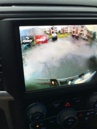

I have a 2016 ram1500 sport with the 8.4 nav and back up camera. I would like to add the cargo camera. Has anyone added this camera to their system? Is it possible i know i will have to add the brake light camera system, is the wiring there already? thanks for any help

You will need the camera, wiring, and some way to get the radio to show the second image. This is typically done using something like the RAX Jailbreak.

Ok thanks. I was hoping that integrating it into the stock radio was an option

The rax jailbreak is using the stock radio. it gives you the ability to have the multiple cams. it will also let you view the cams when your in motion.
from the factory if the truck has both the back-up and cargo usually the back-up is in the mirror and the cargo is on the screen.

I am hoping to add this camera without adding anything aftermarket. I have the 8.4 screen with nav and the backup camera from factory. I have searched and im guessing its not a popular add on or want from people.

In that case not do-able to have both show on the 8.4 screen.
