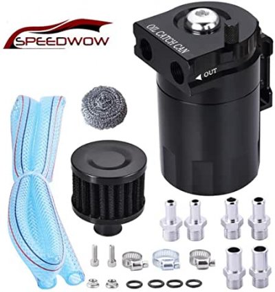

In trying to keep my Ecodiesel going for a long time I installed a catch can. I used 5/8" hose the first time and soon threw a code, open crankcase vent or some such. Redid it with smaller hose, 1/2", on advice of some members on a Facebook page and still the same result. Also worried about causing oil leaks because of pressure or lack of it in the crank case. Any advise is appreciated. Thank you in advance for your help.
This is the style of can used.
