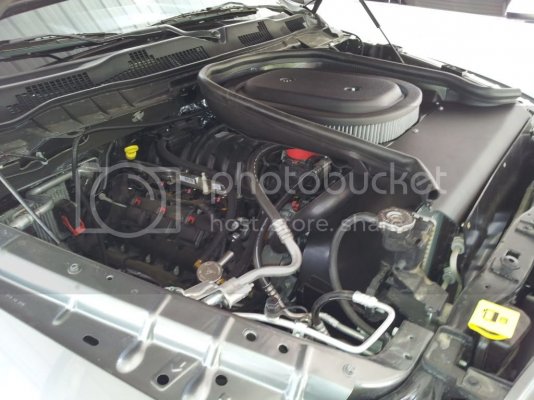

Installed this a couple days ago. Like it so much had to take a pic!

You know what else looks good under the hood?
A Vararam :D

I usually empty mine every 1500-2000
Heres my engine bay :D

there is a definite increase in power. the Vararam seals perfectly with the hood, which means the air its grabbing is directly from the front grill and not from the hot engine bay.
