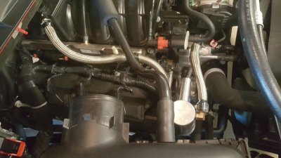

You should be good to go with the catch can. I have one from Billet Technology. One bolt and two hoses, and it is on.
