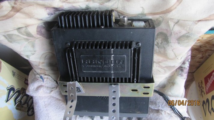

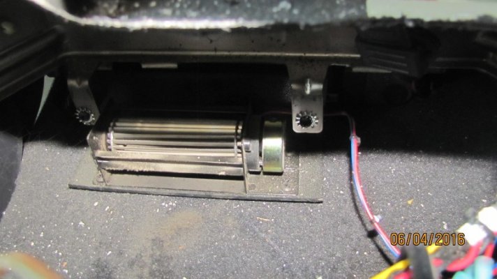

If you take the top of the Full floor console off
There is more room than you think under there
For my radio, i have Heat Sinks & because it is a confined space, i installed a squirrel cage fan
It is mounted on the transmission tunnel
These images were from my 2009 Ram
mounting brackets had to be jury rigged
Lift out the rubber pad & you will see 2 screws
Those 2 screws HOLES may or may not need to be cut out along with some other plastic

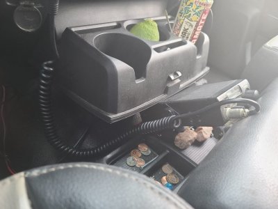

I don't know your layout but in my old '03 I removed the cupholder...
It looked better in person than it does in the picture. Worked great there, could also still have 3 people in the front seat.
I'm not really a CB guy... but living in OK, I just loved having the weather radio :hahano:
