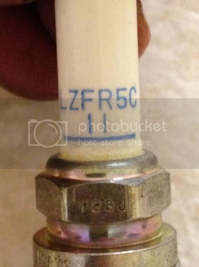

Here are some pictures of the plugs. Do these look normal and in good shape? I have never pulled plugs on a Hemi. I did notice all 4 plugs I pulled had the same black spot on one side of the ceramic near the electrode.

One of those plugs is not like the others. The one where the ceramic is all black in the pic, where is it from?
All 4 plugs I pulled (both from #4 and both #7) had that black spot on the ceramic. You can not see it in all the pictures but all 4 plugs looked identical.
I just bought the truck but looking at the electrode and core of those plugs...they look relatively new to me. I just bought the truck and have not changed any plugs.
