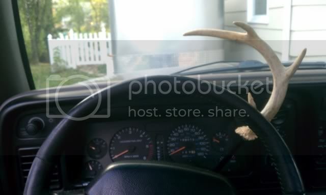

The stick is smaller inside the knob than it is through the rest of it. The diameter is similar to a no 2 pencil with the robbed shaved off. About 3/8 - 1/4 in diameter. Do you have a pic of the knob? I've made lots of knobs and done swaps like this a bunch. For your overdrive button though you can run a toggle switch instead. It works the exact same way fundamentally as the button does and looks way better IMO

Light it up with leds, the shaft is hollow on your shifter I believe. Mine is solid since the o.d. button is on the dash. If you could put a button into the plastic on the end of the knob that would be sick. My antler is attached with epoxy just like factory. I would assume you would do the same with the acrylic you have Luke. But I would still like to see codes new shifter he wants to mount.
