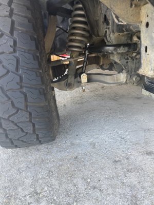

+12 offset may be tight on that upper control arm with 35s. I have -12 offset and 35s and have about 1” of a bit more clearance. Not exactly sure on my clearance since I haven’t measured it. This is the best picture I could find. Hard to tell my clearance from a picture.

Man yea, that looks close. Also I have a Maxtrac 4.5 lift kit that is sitting in my garage, waiting to be installed. This is what it says on their page on their kit.
  • Track width increase of 1" per side
  • MAXTRAC SUSPENSION DOES NOT ADVISE USING WHEELS WIDER THAN 9" OR WHEELS WITH LESS THAN 4.5" BACKSPACING
I'll check the backspacing on the wheels..

You need at least -12 offset to get you the backspacing to clear the knuckle.
I have -12 with 37x12.5 on my 17" wheels and there is about 3/4" between my tire and control arm. +12 will rub, 0 will rub. -12 is as close as I want to be lol... I partially want to go back to looking at wheels now to find something closer to -22 to -24 just to give a little bit of space up there.

Is your truck 2wd or 4wd?
The 18" wheels might not work
And I agree with all ....at least -12 os

Ok....you might want to check the details on your lift.....I know your said it was Max Trax .....but on my Rough Country 4" 2wd ...it says " will not work with 18" wheels "
Hope this helps....
