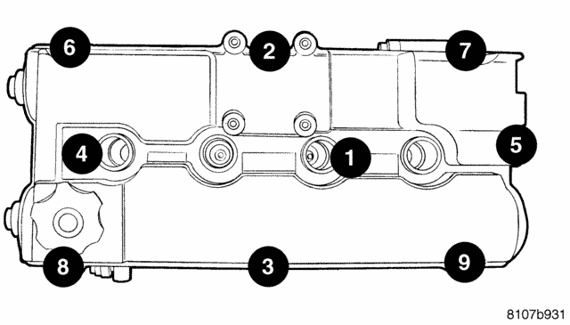

The valve covers call for 106 in-lbs ,just slightly under the intake bolts at 108 in-lbs / 9 ft-lb,at least that's what my book says,although this guy says 70 in-lbs. My book is on the cars,but i can't see them being any differant then the trucks,as they use the same valve cover to my knowledge. Hopefully some one who has access to the trucks tear down manual will post up what the trucks call for if it's differant then the cars 106 in-lbs
I was hoping Summit had the valve cover torque spec,but it's not listed on this page.
Did find this,and it looks like 105/106 in-lbs is the valve cover torque.
Install cylinder head cover assembly to cylinder head. Install all fasteners, ensuring the double ended studs are in their proper location. Tighten fasteners in sequence shown in (Cylinder Head Cover Tightening Sequence). Using a 3 step torque method as follows:
Tighten all bolts to 4.5 N·m (40 in. lbs.).
Tighten all bolts to 9.0 N·m (80 in. lbs.).
Tighten all bolts to 12 N·m (105 in. lbs.).
