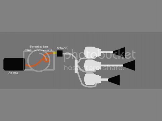

I got the idea from someone on a jeep forum that made them and I just changed it up a bit. Not sure if I can post a link to it but heres some diagrams I drew up to help
For the diaphragm I used a plastic painter tarp that my parents used to cover the floor when painting. Its pretty thick and I havent had a problem with it yet. I read a lot of people used aluminum flashing or just thick plastic, but to do that you need to have those rings that hold it to be completely flat so they sit flush with each other and dont leak, which mine werent lol. I also read something about using a bike inner tube for it, I might try that eventually if the tarp fails. You dont have to cement any of the parts together, the only one I did was the 2" to 1" reducer because I wouldnt need to take that off.
For the main reducer size you can either do a 3" or 4", and those rings would need to be that size. I did 4" but I would recommend 3" because it takes up a lot less room and will still give you the same loudness
and heres how I have my setup. Ill get pics tomorrow, I dont have it put together right now because Im trying to find a leak that I have near the solenoid

Lol I know, I was serching for really cheap train horns and came across them. The rings go into the reducer and the diaphragm goes in between them so they hold it in place. I saw the same thing about the containers, I didnt have any to use but I tried the plastic from a gallon of milk and I had the same problem that I had with the aluminum because my rings werent even and it leaked.
