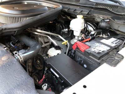

I use aluminum foil over the plastic bag trick. It locks it down really well. Here’s latest wash. Ignore the cowl, I am replacing that old piece of plastic!
I use all purpose cleaner (Adams) but any will do. I use brushes to get in nooks and crannies. Hose it off, start the engine, let her dry. Then I dress the plastic and hoses with Adams VRT.

Is this your 5.7 if so, where did you get the Hemi coil pack over lays lays??? (Good to know that there others who know, our engine run better,,,dressed up)
