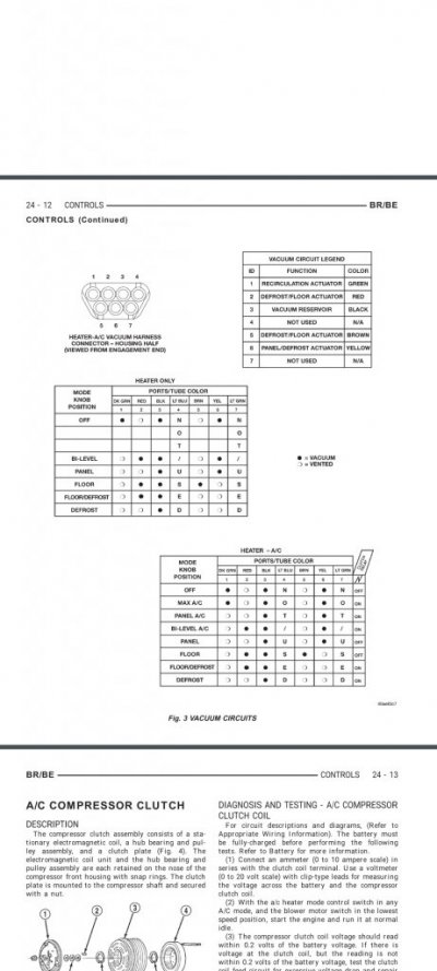

Under my dash,there's like a vacuum line junction connector,and all the hoses are torn,or chewed by mice

I found this info in the service manual. Attached is a pic of the page. I didn't find a routing diagram if that was what you were after.Screenshot_20230606_182216_Xodo Docs.jpg
