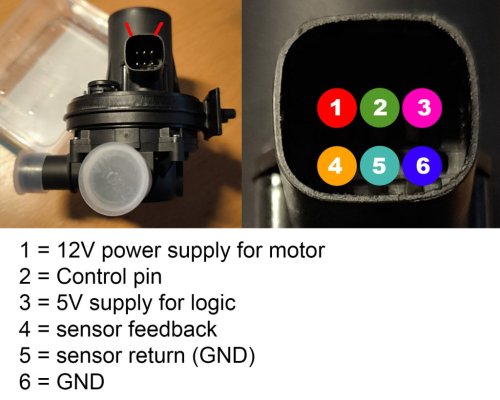

Currently I'm fiddling with F4850R27 HVAC valve (Father Motors) which is an aftermarket copy of RAM Ecodiesel 52014971AB.
Thanks to this forum now I know the pinout on the valve side. However, the pin numbering was missing.

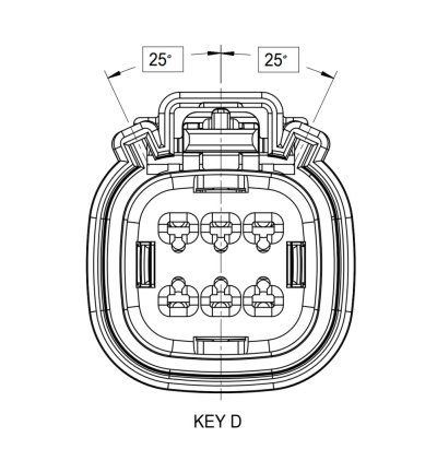

Since I don't have a RAM truck I don't have any harness either. So I tracked down the mama socket and it's highly likely a Molex mx150 33472-series 6-pin 3x2 socket with keying option D.
Unfortunatelly, my local stores had only keying option A available so I had to grind off the plastic keys on the valve side (2 red lines on the photo).

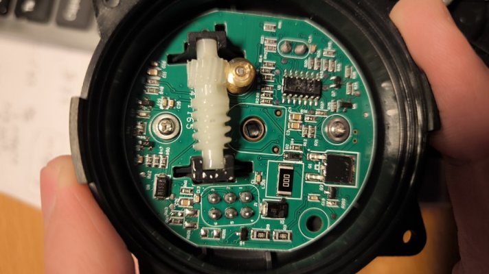

Also, here is the insight of this F4850R27 valve (please note the corresponding numbering of the connector pins on the PCB).
Now that I know the pinouts I'm ready to have the valve powered... But I don't know the parameters of the control signal.

Alright, I've successfully reversed this valve and here's the info for those who might be interested:
DISCLAIMER: this info corresponds to my F4850R27 HVAC valve (Father Motors). Though it is an aftermarket substitute of Mopar 52014971AB valve one should bear in mind that some differences in figures might take place (fine matching is not 100% guaranteed).
(1) Pinout
Once again, I'll make a copy of the pic from the above just to have all the relative info in a single post:

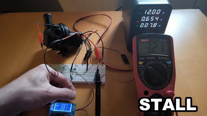

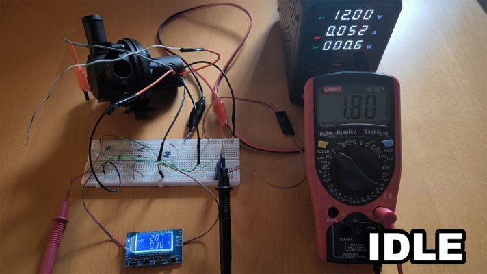

(2) The valve travels 90 degress between 2 endpoints:
- "100% flows to HTR": sensor feedback = 3.2 V
- "100% flows to ALT": sensor feedback = 1.8 V
- the ECU can stop the motor in any arbitrary position in between with a feedback voltage in the range of 1.8V..3.2V.

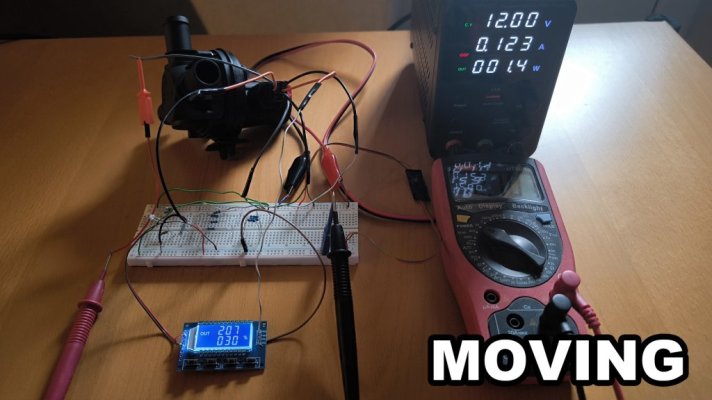

(3) Power consumption:
- when moving the valve draws 140 mA
- when idle the valve consumes only 50 mA (feeding logic only)
- when motor stalls (trying to get over the endpoint) = ~650 mA (I saw up to 700 mA once)
(4) Control
The motor rotates while PIN2 receives the PWM signal. Once the signal is off - motor stops in the current position.
My rough testing shows that the valve likes the frequencies over 25Hz. Operation under this value doesn't sound nice. I stopped testing @ 207 Hz just because got tired :) In the range 25..207 Hz motor sounds the same.
The direction is controlled via duty cycle:
Duty range / direction
- 10..37% / "HTR -> ALT"
- 62..89% / "ALT -> HTR"
I like 30% and 70% values and my valve appreciates that too :)

Below are some pics just for fun // the breakboard carries some junk resistors and led but they have nothing to do with the test... just didn't want to pull them out :)
