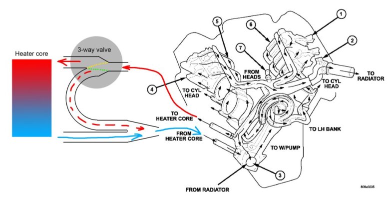

Okay, you are definetely right in the way that troubleprone item is not a brilliant idea.
I will revise the concept once again on the weekend...
Thank you for your time!
PS. An illustration of the initial design:
Years ago alot of vehicles used to use a manual valve in the heater core feed line that used a cable connected to the dash heater controls to manually shut off the flow to the heater during the summer months.That'd be your simplest,least trouble prone set up. I've actually done that trick years ago on a couple of my old vehicles,i just used a Choke Cable to control the underhood valve,and it worked good,and was simplicity onto itself to build and use,and never gave any trouble.Pull the cable to shut off flow,push the cable to restore flow to the heater core.Infinitely adjustable and totally reliable.

Seems like an electric valve with a relay. That when you turn setting to low will activate relay & shut heater off . Would be a lot simpler . Than using a part that is prone to fail. A double valve could probably be found. And the heater core doesn’t care about the flow rate , if hot coolant is moving through it it’s going to heat. Sounds like you’re trying to fix a blend door issue by opening a window.

The other half most likely goes to the heater core as you show but your missing the transmission part of the diagram.
