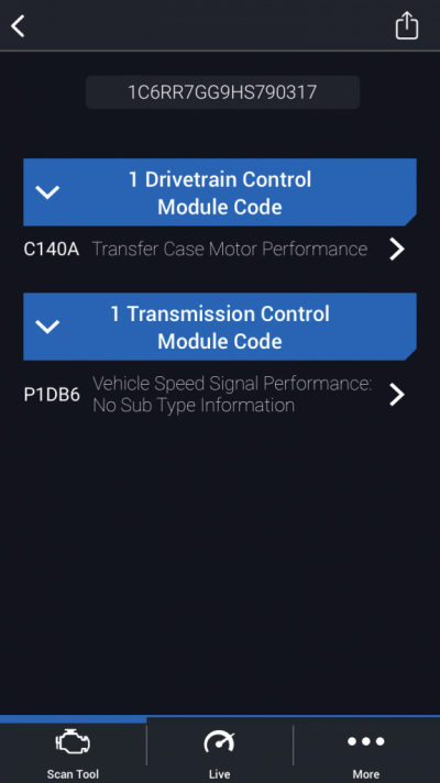

Anyone have knowledge with this tranny speed in speed out code? Its second code in pic. Does not. Set light but it’s always present when i scan. Tranny seems fine and has been serviced. I read it reads speed in, speed out and wheel speed together. I wonder if its my 3;55 gears that i got as option and they weren’t programmed into truck? Or possibly a TSB was issued for this?

The Transmission Control Module (TCM) can detect rationality failures of the input (turbine) speed sensor and output speed sensor signals as well as the wheel speed and engine speed signals received through the Controller Area Network (CAN).
The TCM performs three diagnostic checks that include:
- Multi sensor comparisons of up to three speed signals (input, output and wheel speed).
- Monitoring of the gradient of the input speed signal.
- Double failure monitoring to determine unique failure situations which could require unique limp-in functionality.
Based on this description of the code. I think you are headed to the dealer unless you want to fire the parts cannon
