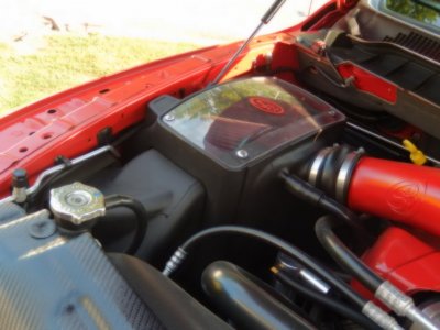

This is a CAI that really works. According to my Bully Dog my intake air temperature is less than 10 degrees over ambient, when cruising it is usually 5 degrees over ambient.
