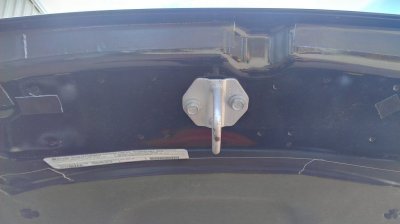

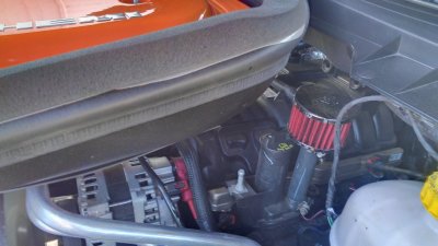

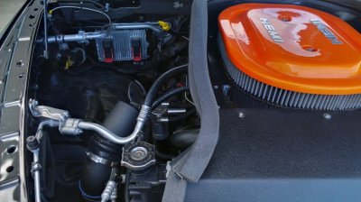

I have 3 CIA. Before the Cam/Head mod I ran the Volant with the ram snorkel. After the Install, I noticed the speed at 100MPH really slowed. Bought the Vararam, the truck will hit 120 like a hot knife through butter. I like all my intakes. Personally it is better to run a closed box intake for reasons I will leave out for now. I did a couple mods with the vararam to make it alittle better. 1) removed the weather striping on the hood and black ducked taped evey hole and sealed the liner to the hood. 2) doubled faced taped 1 1/4 inch air conditioning strips over the existing weather strips on the vararam for a tight seal where the hood liner changes depth. NO WATER splashing up in the back corners. 3)left the ram snorkel in and modded it for fresh air in the engine compartment.
Who knows if any of it made a difference, but its fun trying to figure a solution to a problem.
