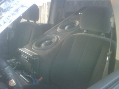

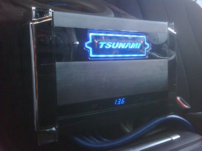

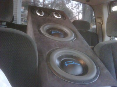

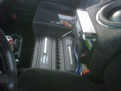

Sry i couldnt get the pics up yesterday but here are some of the system
