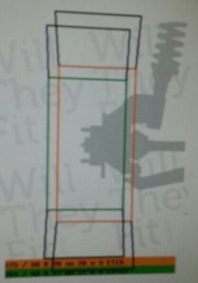

I found a great website: Willtheyfit.com that helps visualize rims and wheels. Just type in the size you have and the size you want.

Here's my new setup based on that website. I went to 31.6" tires from 33" and from 20" rims to 17"
