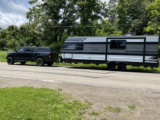

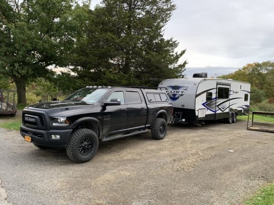

I’ve pulled campers pushing 12,000lbs with a 6.4, 66RFE, 4.10 gears! With WDH and bags, it pulled everything comfortably in the hills, at freeway speeds, winds and rainstorms! Quite often over the PowerWagon’s ratings as far as weight goes!
Gas mileage is dismal in the hills, but it’s still a joy for me to drive!
If I towed weight daily, I’d probably look for older 12valve Cummins with a 5-speed!
