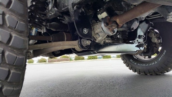

My lifted truck buddy that is 50 has been lifting trucks most of his life cautions me he would exceed 2" leveling. He believes its not worth it. Feels actual suspension lift to lower transfer case is required. ��

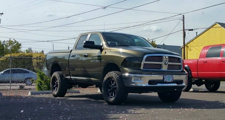

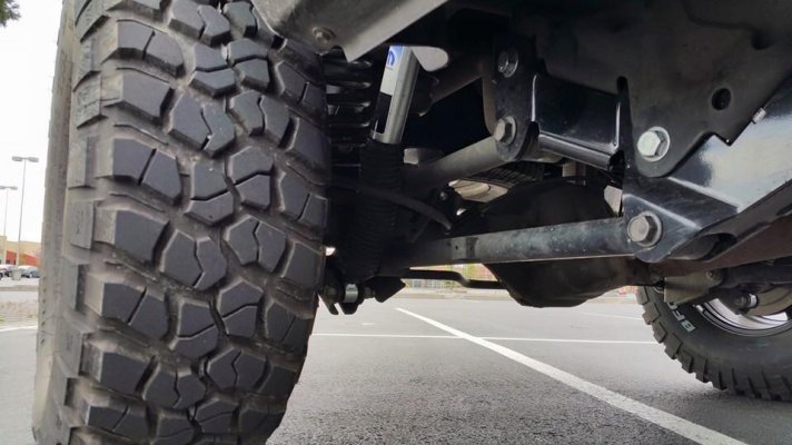

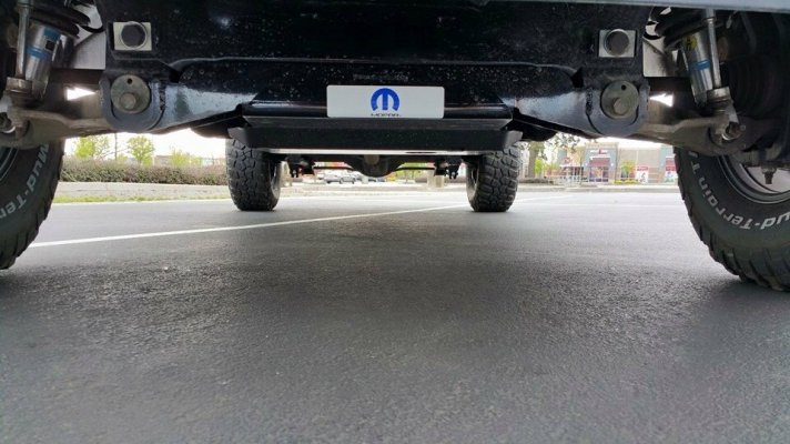

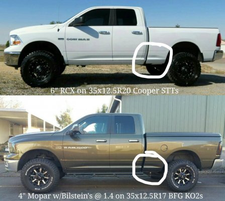

e8f992f58bad44d8fa6ef1e0cae075c4.jpg129c658eb31b1b4e9a9bba37ab3e580a.jpg5f4998129811056572cc8e83db8748b0.jpgMy Mopar (Superlift) came with all the drop hardware necessary for the proper relocation of the front and rear axles. As well as a spacer for your front driveshaft. The angle change is very minimal. I'd be more weary of the angles on your front CVs with a leveling kit

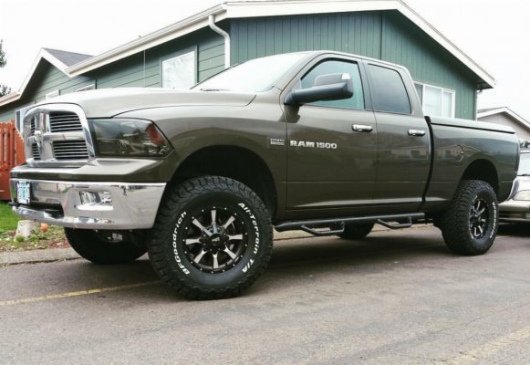

I was running a 305/70R17 KM2 (34x12)e2bdb6a2b760afe8591e54bc5090ca54.jpg then bumped my Bils to 1.4 and put on 35x12.5R17 KO2s655b56e349a971ed7eacd6f526a58d7e.jpg

Loved my 4" Mopar (Superlift). Comes with Bilsteins on all 4 corners. Ended up adjusting them to 1.4 and was running 35s on her. Paid $1865 for everything. BDS, Zone, or Superlift is what most would recommend. My biggest gripes with RCX lift on these trucks is that the rear they just pop in a spacer. No control arm brackets. Causing your rear angles to be all off. b2bd5f24734798d70c627b67f6a920c4.jpgas you can see there are no drop brackets even on their 6" lift. Also the 4" with Bils at 1.4" puts you at a true 5" lift. Sits 1" lower front and rear than a 6" on the same size tires. Measured a few people's I've ran into. But like stated above, some people like their RCX lift. I mean I'm running their 2 1/2" level on my new truck, although it's temporary until I get Power Wagon springs
