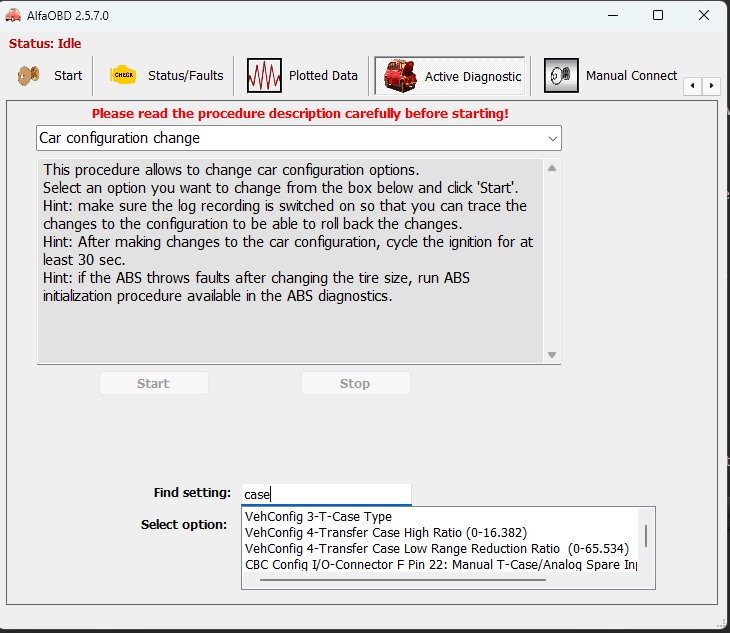

2. Dash Switch & BCM Configuration: If I install the 4-position dash switch (2WD, 4WD AUTO, 4WD LOCK, 4WD LOW), can I enable the Auto 4WD feature in the TIPM/BCM using AlfaOBD (by changing the Transfer Case Type in vehicle configuration)?
