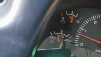

My 99 5.9 is not making a lot of heat in the cab. To me the temps are running a little cooler but not positive. The fan also kicks on as soon as I start the truck no matter the temp. I am thinking it is a thermostat stuck open but not positive. Looking for ideas. This is the normal operating temp for the truck. I have had it for about 2 months now and as its getting cooler I want the heat back.

Should have plenty of heat at that temp.

All of the 5.9 trucks I've had ran a little warmer than that, closer to the 210 mark, with the last one I had being the exception because I put a 180° thermostat in it. And I regretted the 180° thermostat when winter rolled around because I had poor heat. After swapping the standard thermo back in, heat was better but not as warm as the previous truck. Turned out to be a plugged heater core.
