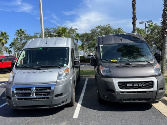

6 cylinder gas penstar
Fan comes on but does not have enough time to do any cooling. Off 8sec, on 4 sec, off 8sec, on 4 sec ………. Continues all during idiling. Not during driving. Not during coasting. We also discovered today if the AC IG off and the interior heat is turned on too high it continues fast cycling. The entire cooling fan system was replaced under warranty about 1 year ago and comes with a 2 year part and labor warranty. We tested a new 2022 van yesterday and no fast cycling. We have listened to a fedex delivery vehicle and no fast cycling either. Daytona Dodge Garage refuses to replace the assembly insisting it’s ok despite anyone who comes near the vehicle asking why is it doing that. Any suggestions? I thought thermostat maybe isn’t opening at idle and trapping excessive heat and fan try’s to cool it but does no good.
