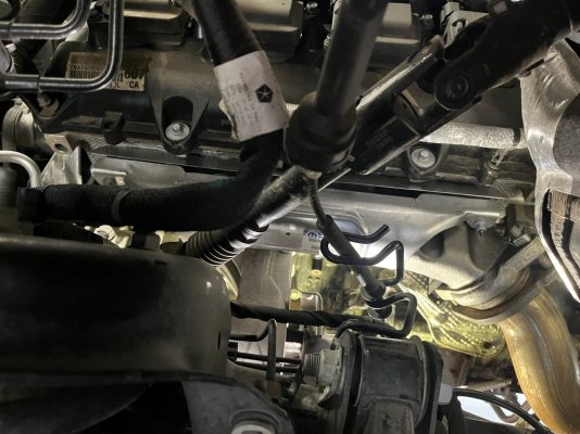

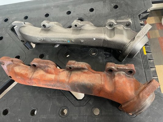

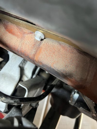

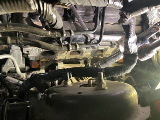

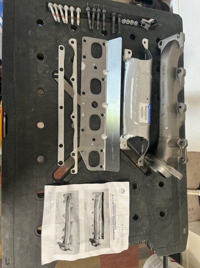

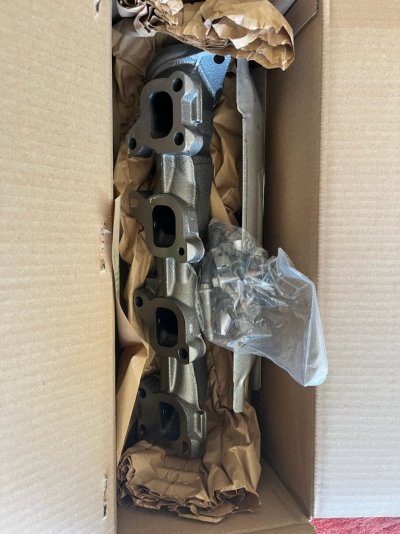

Helped my dad get the manifold swapped out this weekend.
Looks like there is a different part number on the new manifold, slight changes to the design but nothing drastic. Wonder how this new one will hold up.
Wasn't too bad, way easier than putting the LTs on my 4th gen. The dipstick is easier to mess with on his 5th gen too. Took us about 3 hours or so. And I was rotating my tires at the same time he worked on his truck.
From what the dealer told us, you can only buy the manifold as a kit now. And it came with everything including extra bolts for about $200ish from what my dad told me. I didn't double check what it cost but that seems pretty dang cheap!
I'd much rather break the manifold over bolts with how easy this was and since the kit comes complete.
Keep us updated on how they pan out G,as i'm wondering if this might be an upgrade that'd also work on the 4th Gens.
That would be $200 per side i'm guessing

Will do. I am expecting to have to put some in my truck eventually too so I wanted to help out and see how bad of a job it was. Yeah $200 a side. He only replaced one.
I don't remember off the top of my head how the 4th gen manifold looks but, looking at the upgraded BD diesel version of the 4th gen manifold, it looks like the collector doesn't have as much of a bend as the 5th gen collector does. He was planning on getting BD's until he realized his truck was a DT.
Here's the BD 4th gen for comparison.

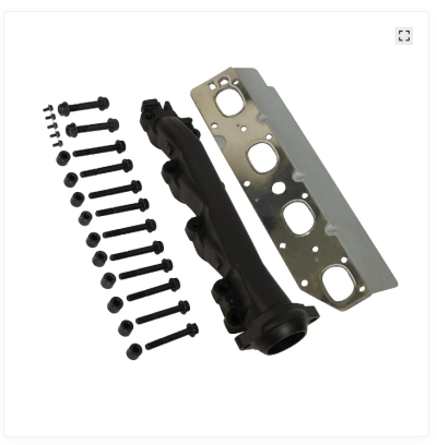

Hay G-Ride990 BD Diesel now have the exhaust manifold kit for the DT's, I just purchased them they fit great, I had a cracked one on my driver's side.

Get rid of that factory junk. I bought my new ones from BD oil with gaskets and bolts for $513 shipped. One weighs almost 2 lbs more than the factory one, and the other is over a pound more. They shipped in 2 days.
I put BD diesel manifolds on my 2017 Ram 1500 due to broken bolts, they're heavier duty and have better bolt system which should alleviate bolts breaking.
