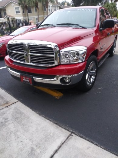

I just got it painted as well and new headlights will install new carpet soon and will def check out those bed lights3789adf8a1d54bb148bc68e4f0c7fc6f.jpg
