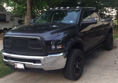

The retrofit source put together a package for retrofitting really good projectors and HIDs into the stock housing. That said, I couldn’t get my stocks apart and bought aftermarket. Complete PITA to align now though. But looks good and cast a really good line of light with a flat cut off so people don’t get blinded. Bonus is that the cut off is on a solenoid that lifts it out of the way when the high beams come on giving me quad high beams. I am running them off of stock harness without capacitors or resistors thanks to the Fiat software I bought that allows me to go in and change options on the truck. I just changed low beams from halogen to HID in the BCM.
