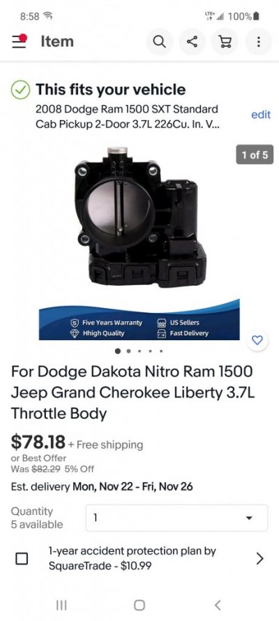

You don't have an electronic throttle body, so you have a servo somewhere.
Nope I was wrong. I was always under the impression that in 2008 only the 4.7 got the fly by wire because they didn't really care about the 3.7. If your fuses, etc are good then recheck the connection between the on/off switch and the clockspring, make sure none of the pins are bent and make sure that little bit of harness didn't get pinched under the airbag.
