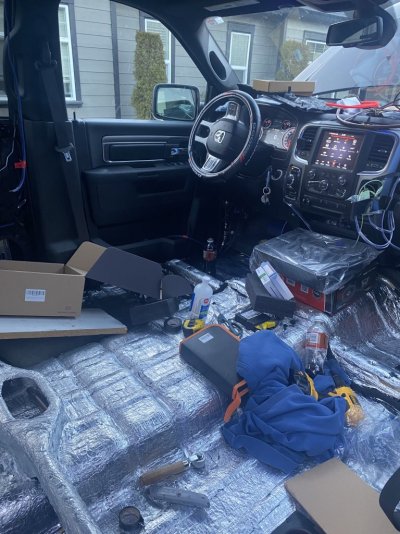

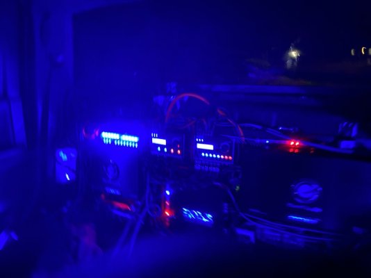

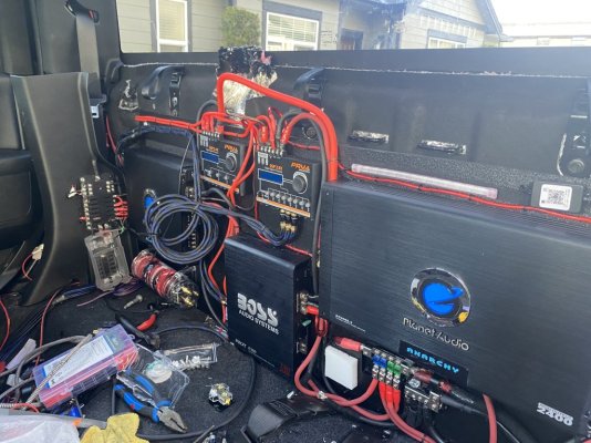

Custom audio system installed, took 3.5 months and OMG does it sound fantastic! 2021 Dodge Ram Classic 1500 Warlock edition. Love this truck so much!

I’m installing a new DSP that hooks up to my computer so I can tune the sound in even better, I still have to install 2 more 6.5 mids in the front doors and which should be fairly easy but then again this project has battled me on every single thing…nothing fit right or had a lot of re-dues to make things jive but I’m proud of what I did on my own that’s for sure…my fiancé…..not so much!

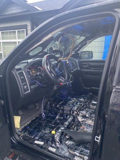

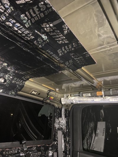

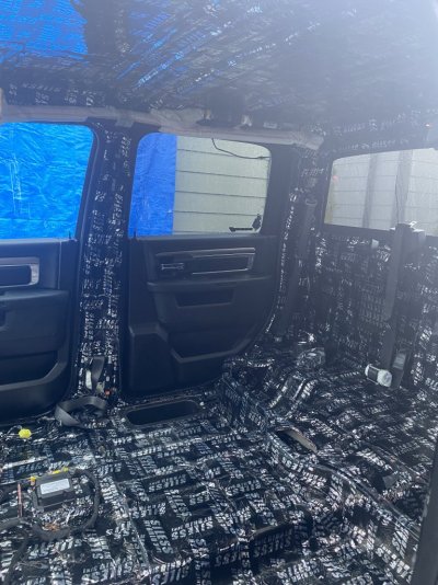

i noticed you sound proofed the floors and roof, including the side pillars. What material was that?

Silless 3 in 1 hybrid 200ml for almost all of it , used thinner stuff on some pannels and door spots but everything went back together. Some spots were a little tight but managed…used 8 boxes..lots of extra wt and my doors are really heavy now but awesome, it’s so quite now and when the music is turned up loud and the windows are closed you can barely hear it outside….amazing stuff but lots of work and getting all the air out underneath is tasking.

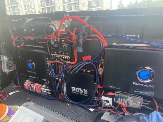

And surprisingly the electric keeps up to the stereo somewhat. If I have it loud and AC with headlights on it will start draining the battery faster than it can charge and the lights start to flicker with the base. I will need a bigger alternator soon…looking at aftermarket you can get up to a 400 amp one but I think I will look into a 300 amp one…which means an upgrade on wire for that as well

May I ask why you used Boss Audio and Planet Audio then installed Earthquake speakers??? Me personally, I would not trust either of those companies for anything quality. Put a planet audio stereo in an Xterra, and it made the sound of the system worse. Had boss audio way back in the day and it sound like garbage and blew when giving it 25% of it rated power. That is why I am asking why did you decide to use this gear? Not trying to be a jerk or anything here.
