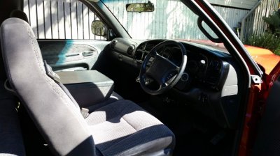

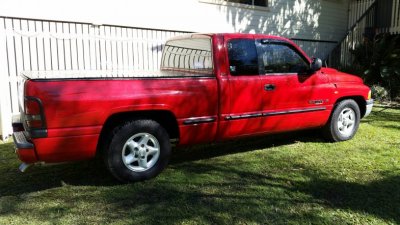

Few more pics

you should do a build sheet thread on that beast. I'm a little curious about what you have done to make the boost work as well as some of those interior goodies.

The complete dash itself is a complete mirror image made of fiberglass. The mold has the same textured finish as original but is laid up with grey gelcoat so the end result comes out looking original. Door window switches are done the same way to transfer left to right and right to left. The Speedo cluster remains the same as do all switches on dash and fit as do when it was left hand drive.....the engine now is less it's efi due to a engine management failure being spiked in a minor accident. This is why we replaced the hood with an SRT looking unit. The engine has a Blow through carb on it. The vortech V2 Supercharger works great...
