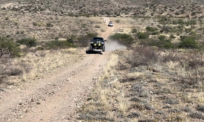

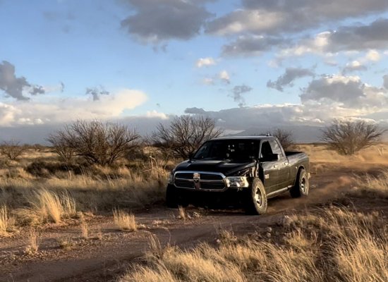

DK is awesome stuff could be very well worth the wait. There is also Zona Motorsports out of Tucson AZ. This is a dirtking kit and Carbon coilover and rear king triple bypass.
